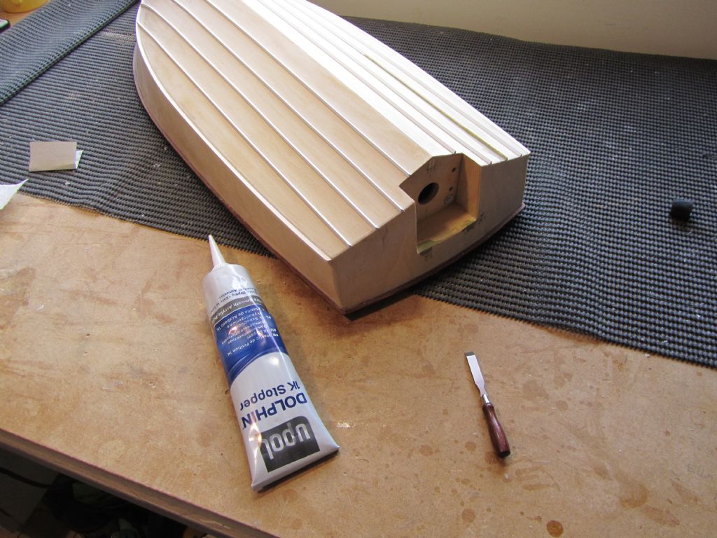

        There were some blemishes to be filled on the hulls (which I'm painting first) so I also bought some fine filler; UPOL Dolphin 1k Stopper. With this hull it is mainly the aftermath of fitting the strakes that requires most attention. I'm pleased with how the plastic strakes worked out with their nice sharp lines and how the canopy glue secured them (a couple of small areas had to be reglued) but unsurprisingly the glue line is wider than the strakes and will be obvious when painted. Usually this would just be sanded but as the glue has retained some flexibility it won't really sand. In the end I've had to resort to carefully using my small Veritas chisels along both sides of each strake and to each strake itself to remove the glue. Also at the strake/hull interface there were small "chippings" of glue that wouldn't just blow off but had to be removed with the chisel. Bit of a ball ache especially as when you thought you were done you'd see more!
        I then debated whether I'd form a small fillet to each side of the strakes. On the Huntress 28 this was easy as I'd used timber and formed the fillet with Eze-Kote and Micro-balloons. I decided I would, using the filler, as in some places there were still signs of glue "chippings" despite my best efforts, and the fillet would provide even more adhesion. I'm not looking for a perfect finish but don't want to spoil my efforts other with the build. So I'm progressing that task but you need breaks!
        I hate strakes! And the Swordsman 33 and Huntsman 31 have plastic ones as well! Thankfully my two planned future Faireys don't have strakes though another non-Fairey project will have – I might use timber on that!

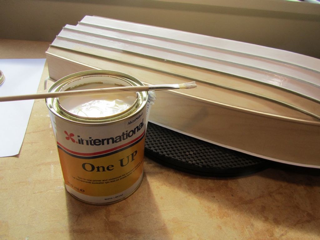

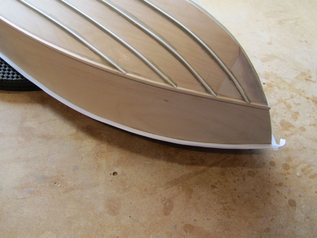

        #101963

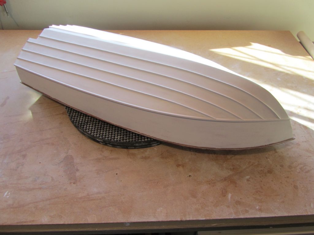

          Filling along each side of the strakes took some time, especially as there were four to each side but that was duly completed. The filler dries quite quickly but I've tried to sand filler too soon before so I left it overnight to completely harden.
          Then I had to sand it all smooth, which I did with small pieces of 350 and 400 grit folded over to get into the angles etc. Another time consuming task but when it comes to paint preparation it's got to be done even if you're itching to get started with the paint!

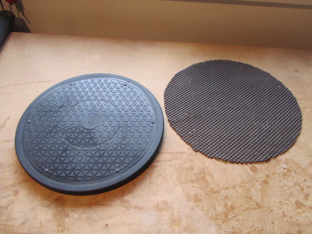

          I'd bought a cheap turn-table off Amazon quite sometime ago in readiness for painting. I cut out a circle of non-slip material to cushion between the hard plastic and the deck and to stop the model sliding about. The turn-table made fitting the Tamiya tape to the underside of the rubbing strip easier and of course then the painting itself.
          I'd bought some good quality brushes for the top coats but for the primer/undercoat I used a cheap brush – it lost a few bristles and left brush strokes but the latter didn't matter as I would be sanding and applying another coat. Some minor blemishes did show up along the keel line so a bit more filling will be required.
          It's nice applying paint, especially where you've used dissimilar materials as it pulls them together and provides uniformity, even though I do like the natural timber finish. I'm pleased with how the strakes look as well even though they have been a bit of a pain!

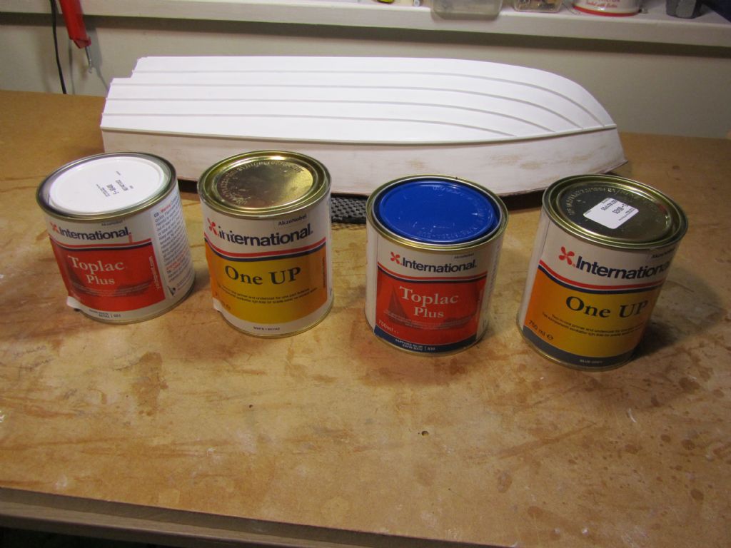

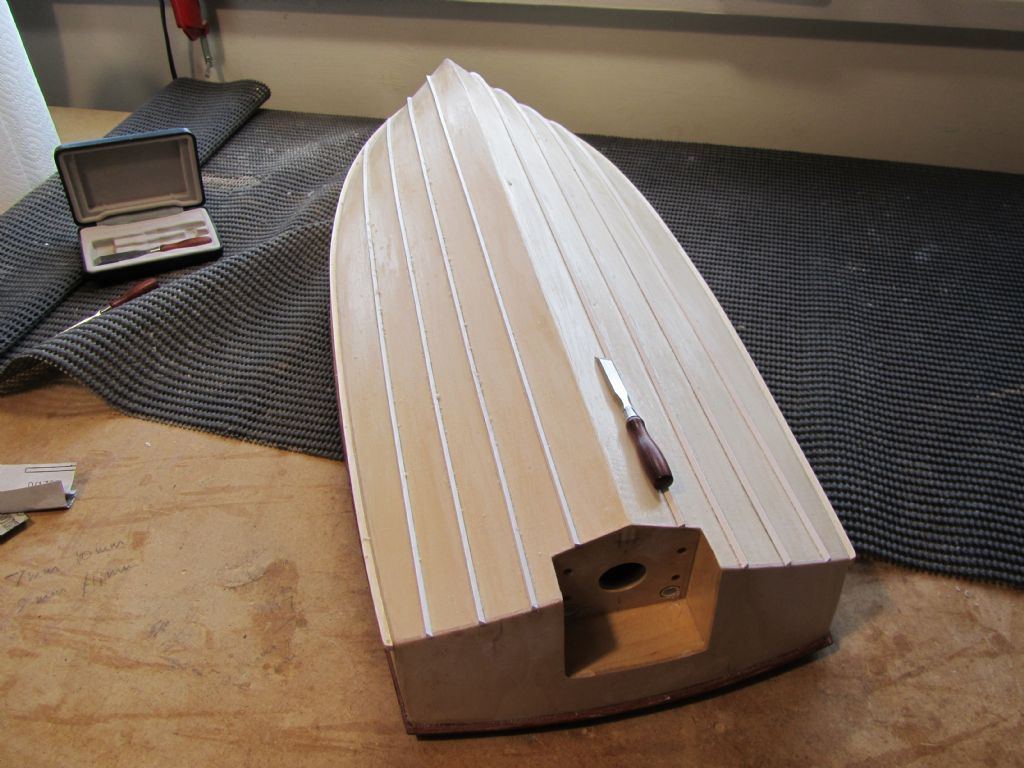

                    Haven't posted much as I'm still doing other things but as winter approaches I plan to spend more time on the builds.
                    As you can see from my earlier post I'm using International Paints paint, being their One UP primer/undercoat and Toplac Plus topcoat. Only used the One UP so far and as you'd expect from a quality paint it is performing as you would want. It covers well and adhers well to the styrene strakes and Eze-Kote to the hull and is suitable for a range of other substrates.
                    When dry it forms a satin finish, which is quite hard, which is good as it doesn't sand off too easily, apart from high points, and so doesn't readily expose the substrate. I did do this in some places as was the first coat applied and partly to identify any areas that required surface filling. Some small areas were required and once dry and sanded down a further coat was applied to the underside of the hull which will be white – decided on this as the styrene strakes are white and with quite a point on them (despite running the silicone-carbide over it) if the paint gets rubbed off in use it won't be that noticeable – may do that on the other hulls with styrene strakes but will see.
                    I ditched the cheap brush as it was quite coarse and left distinct brush strokes which required sanding out. Used a better quality brush for the second coat, which was better but still requires sanding as the paint is thick to apply and thinning isn't recommended. No problem as it does sand beautifully with 400 grit. I have even better quality brushes for the topcoat as recommended by other forum members.
                    The hull sides will be second coated (maybe three once sanded) with the blue One UP once the bottom has been glossed and left to harden. The Huntsman 28 in the background will be the reverse with a blue bottom (timber, well rounded strakes) and white sides.

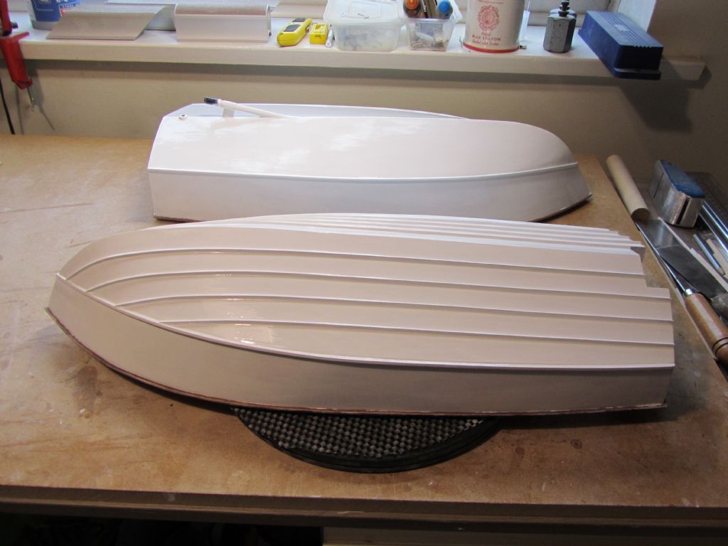

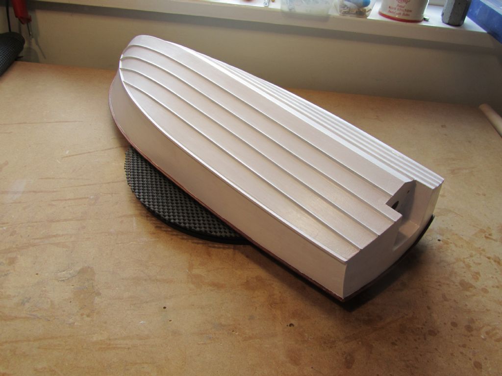

                          Must admit I'm finding the painting a little frustrating at the moment, not helped by doing three at the same time; the Huntress, River Cruiser and Huntsman 28.
                          As I said before the primer undercoat is good but with using small brushes it tends to build up unevenly where over brushing and it starting to dry and also some brush strokes. It then takes quite a bit of sanding to get the paint flat again and is fiddly on the hulls with strakes. When sanding I've also noticed new areas that need a bit of filling which then need to be painted again. After yesterdays sanding I thought I'd be ready to start the top coat today but with the brighter, low light coming through the window this morning I saw that more sanding needed to be done which then resulted in more spot primer and hence more sanding tomorrow! I'm not looking for perfection but I want it to look pretty decent.
                          So that the hulls are completely coated and watertight I'm going to paint them completely white initially and then add blue later or maybe leave them as is. I can then finish fitting them out and try them on the water and then carry on with the superstructures. Once I've top coated these 3 I shall move onto the Huntsman 31 and Swordsman.

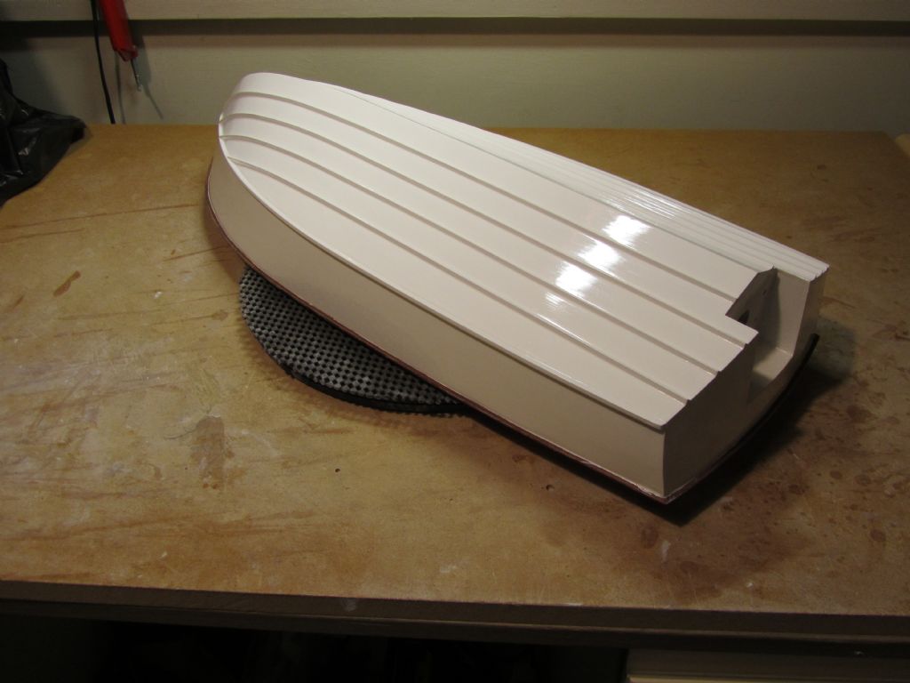

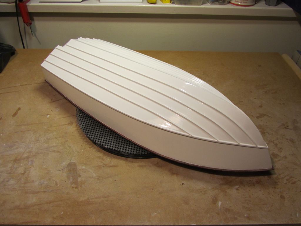

                                  I've now got some gloss on the Huntress as well. I'm pleased with how the styrene strakes have tuned out and the hull looks like a fibreglass/moulded one now!

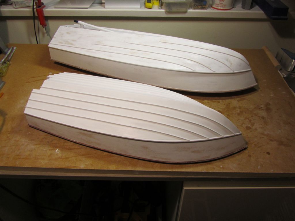

                                        #103291

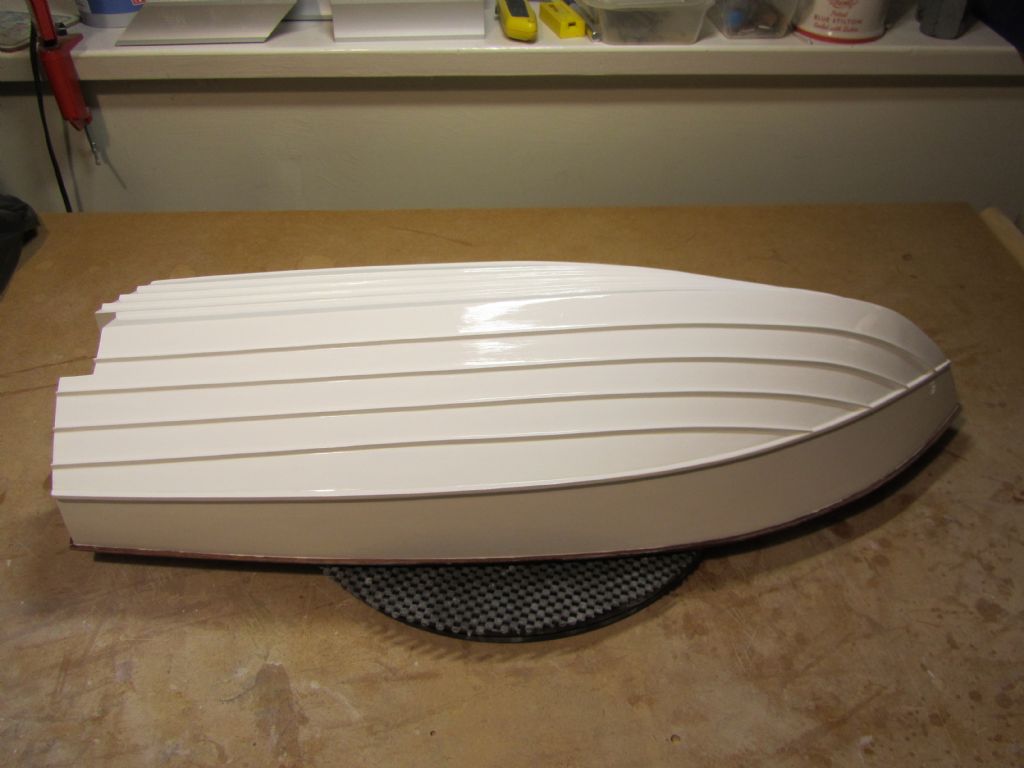

                                          I have been doing a bit now and again over the last few weeks, mainly sanding off most of the previously applied coat!
                                          Despite using good quality brushes, the brush strokes were still more visible than I wanted though the finish was better once I'd thinned the paint a little, though you then have to be careful of runs. paint also needed to be thinned because it was thickening in the tin over time.
                                          Anyway I've called it a day now, having applied a number of coats. The finish isn't perfect but it's good enough, otherwise it's difficult to know when to stop, more so when doing multiple hulls.
                                          Still painting the other two hulls and once done can turn to the Huntsman 31 and Swordsman which will benefit, hopefully, from what I've learned. smiley
                                          I'm very happy with the paint though and once dry it provides a nice hard and hopefully hard-wearing finish, though of course the Faireys will be molly-coddled! laugh

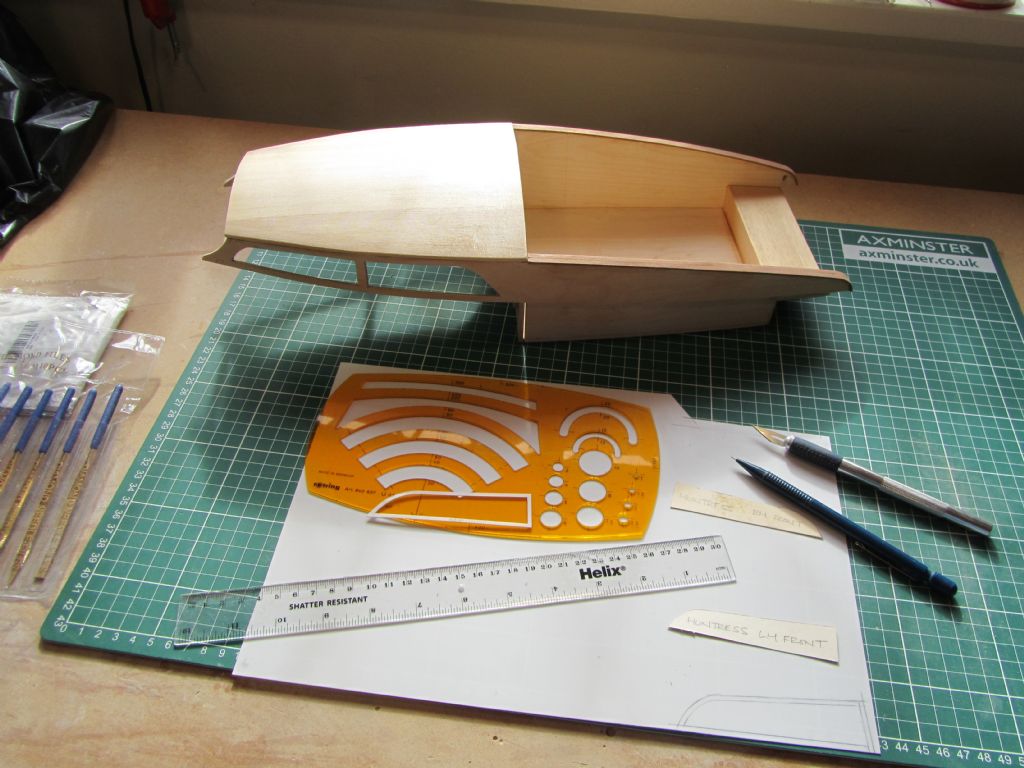

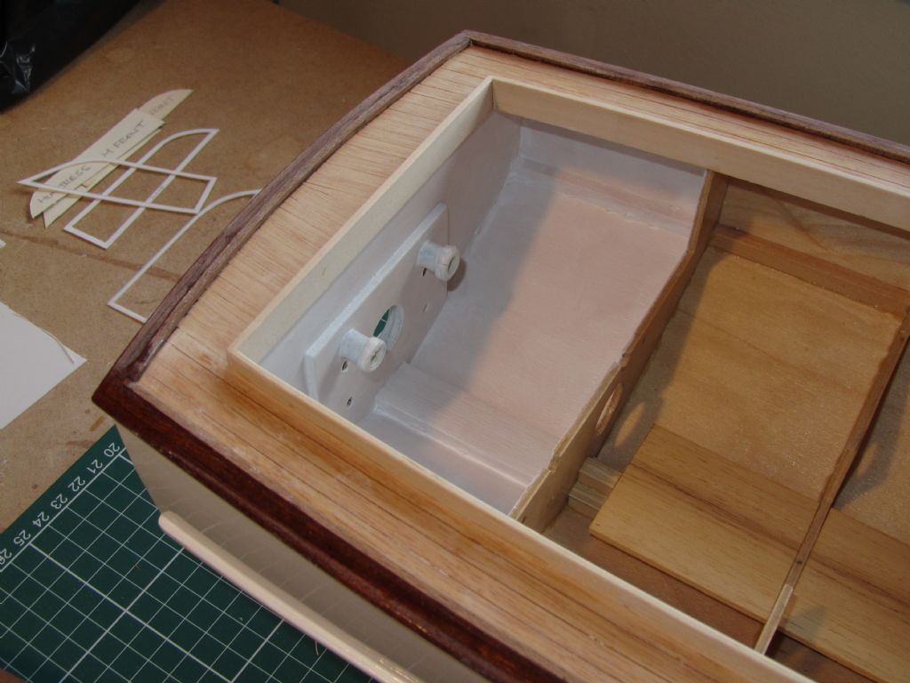

                                                    The trouble with my stop start building is that I sometimes forget where I've got to and the methods used for doing things! Not helped by me having had a tidy up, well more of a rearrange of the workroom and I couldn't find things!
                                                    The fist two problems were helped by looking at my photos and the third just took time.
                                                    Anyway, first job was to begin painting of part of the inside of the hull. I apply a couple of coats of Eze-Kote which provides some resistance to light water ingress but with this model and the multiple holes through the transom, even though I will be using some silicone, there is a chance that water will get into the rear compartment. Two coats of primer-undercoat has been applied and this will be followed up by a couple of coats of the Toplac Plus.
                                                    I then returned to the windows in order to progress the superstructure. Made the other side front window surround from 0.5mm plastic sheet and then one of the rears. When offered up though I noticed that the rear was a bit deeper than the front so I'm going to remake that one. Lesson learned!
