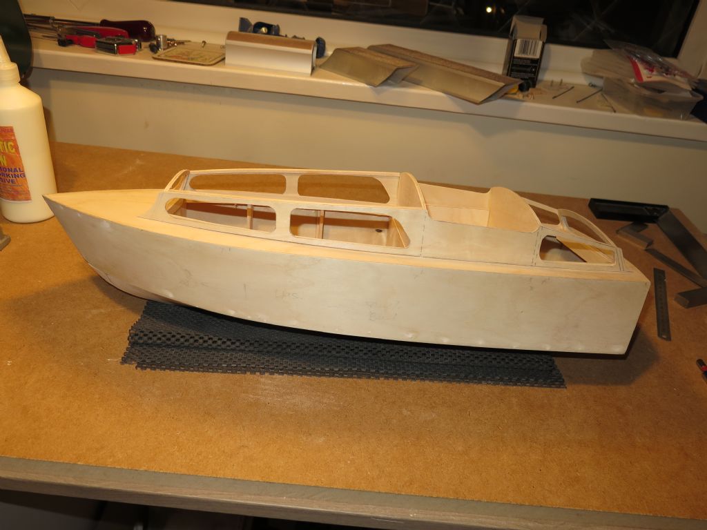

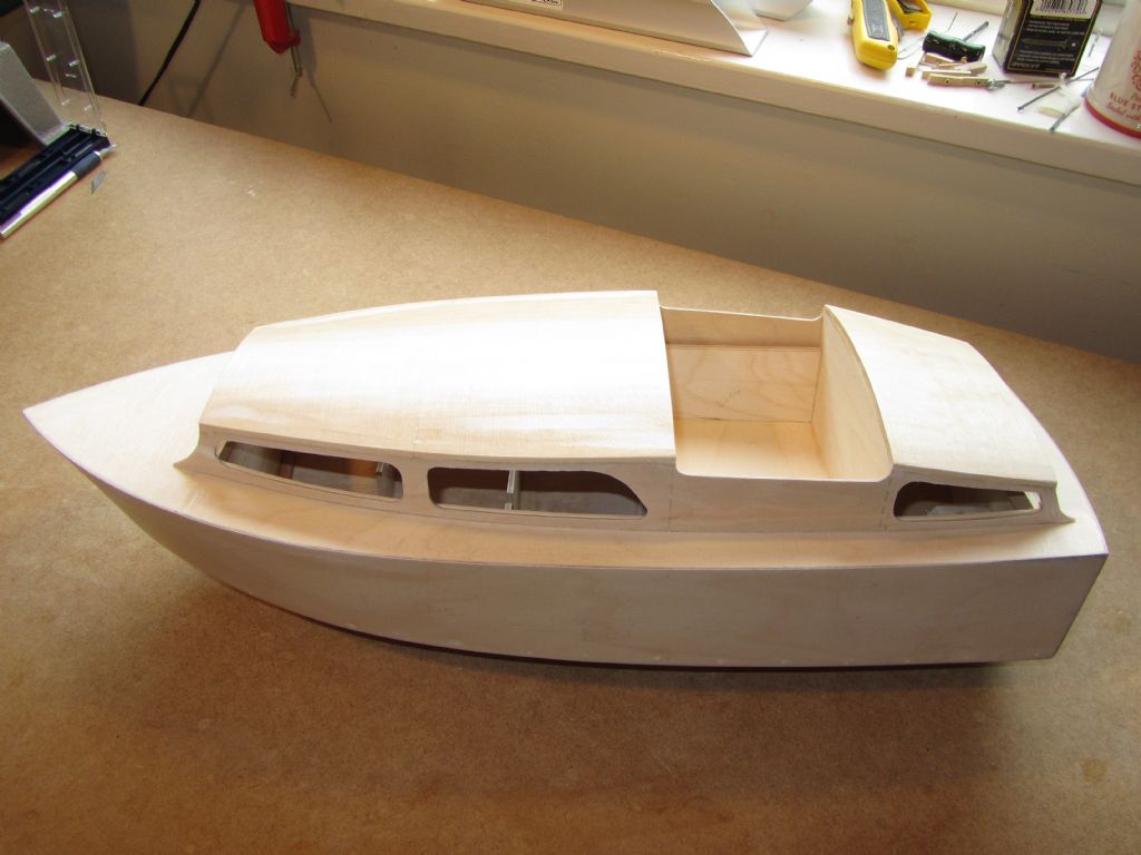

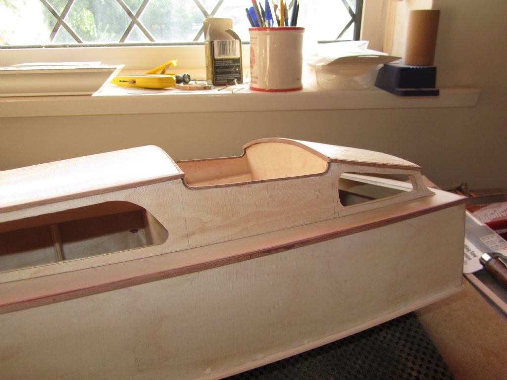

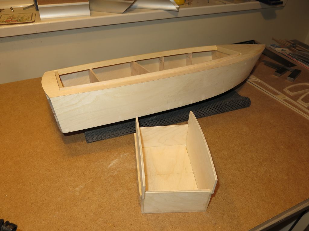

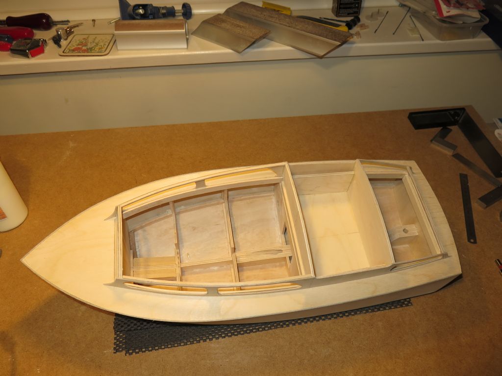

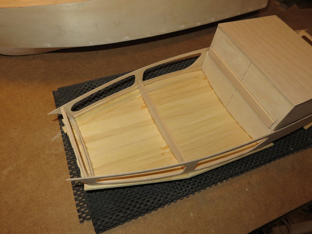

      The box forming the cockpit area and providing support for one end of the roofs has been constructed. Over the weekend I'm planning to fit the cabin/cockpit sides and front and rear window frames and plank the roofs.
      As with the hull, I'm using Dave's Huntress build article for guidance on building methods and materials etc. and will certainly be following his advice when I get to the finishing and painting stages – thanks again Dave.

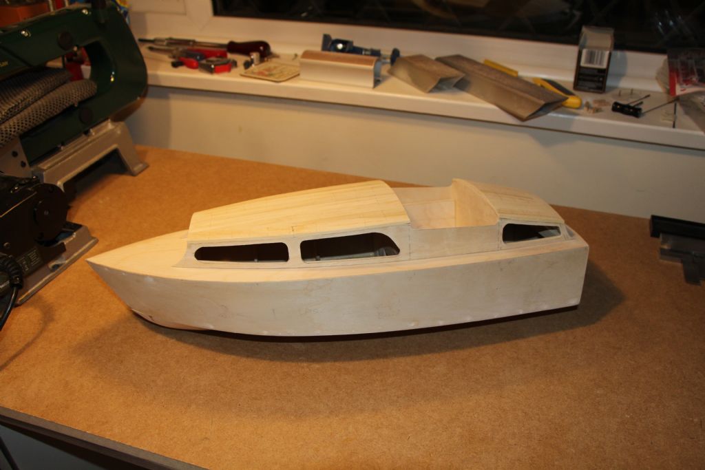

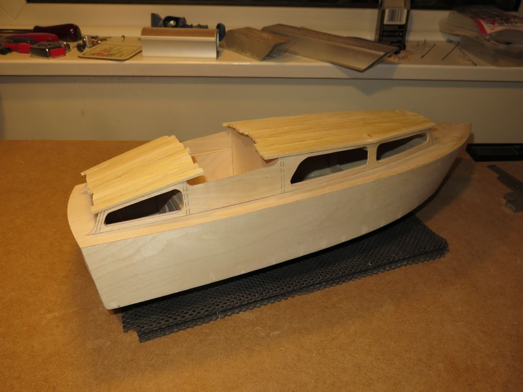

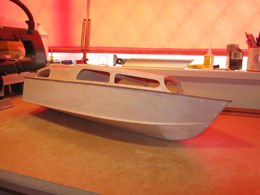

            Starting to look like a Fairey River Cruiser now.
            Was hoping to have started on the roofs yesterday but had to remake the rear window and wait for the glue to dry. I'd cut out the window aperture first but by the time I'd sanded the frame to fit it was too thin at the bottom – I'd modified the drawing slightly, which if I'd left as done originally would have been OK. The front frame was fine though.
            I'd love to crack on but in the interests of domestic harmony it's going to wait until after Christmas now.

              It's quite a pretty little thing, isn't it?
              What sort of wood do you intend to use for the roof? My preference would be bass/lime in strips about 1/8" x 3/8".
              #80409
                Yes, when I first saw it I wasn't convinced of the looks, especially due to the stubbiness of the aft cabin, but as you have found out with the Huntress etc. the different boats grow on you. I would have built it anyway, it being a Fairey.
                As for the roofs I'm following your Huntress article with the timber already obtained from SLEC.

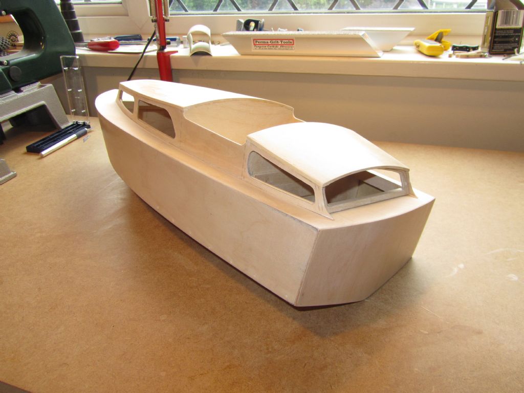

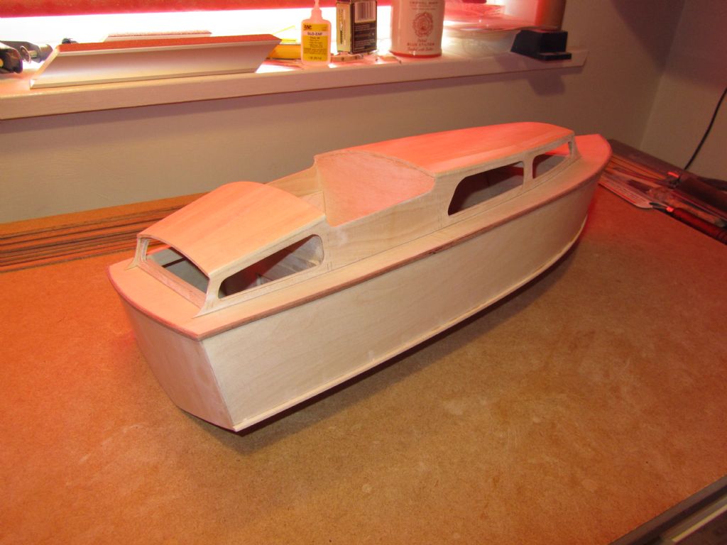

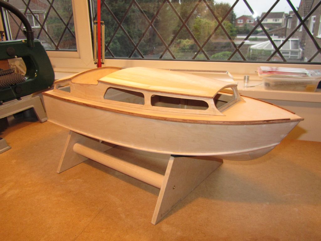

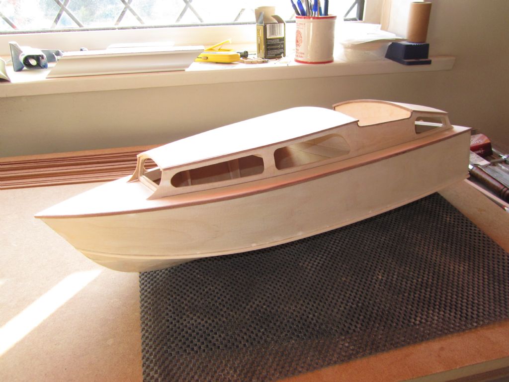

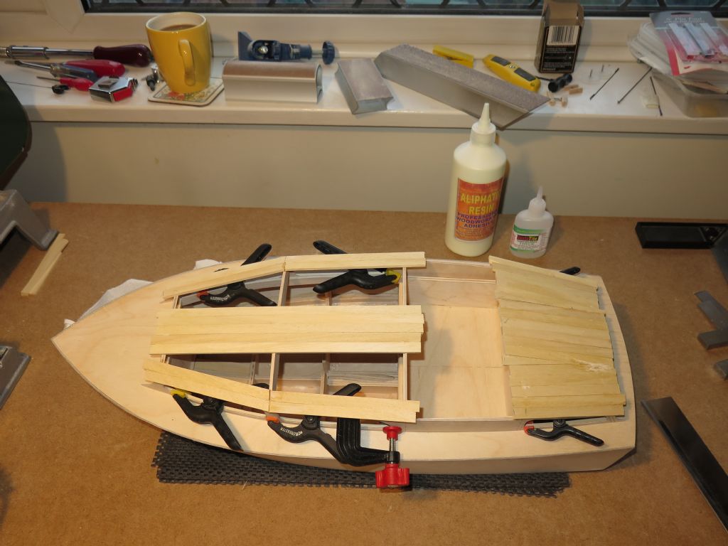

                  Roofs now fitted ready for sanding and trimming.
                  The reality looks a lot better!
                  Edited By Chris Fellows on 28/12/2018 22:04:50

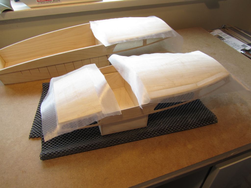

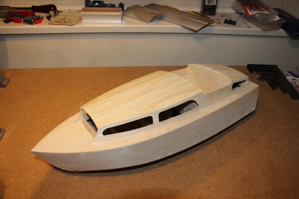

                    roofs 5.jpgSpent some time today cutting and sanding the roofs flush with the cabin sides etc. and gave the tops a preliminary sanding with the trusty Permagrit. Need to do a bit of filling before the final sanding as a couple of the planks were thinner than the others. I could sand the steps out but it will be easier to fill and I'll do it when I fill those gaps at the bow.
                    I'll order the Eze-Kote and cloth etc. later this week but will put the River Cruiser to one side now and drop back on the other two boats.

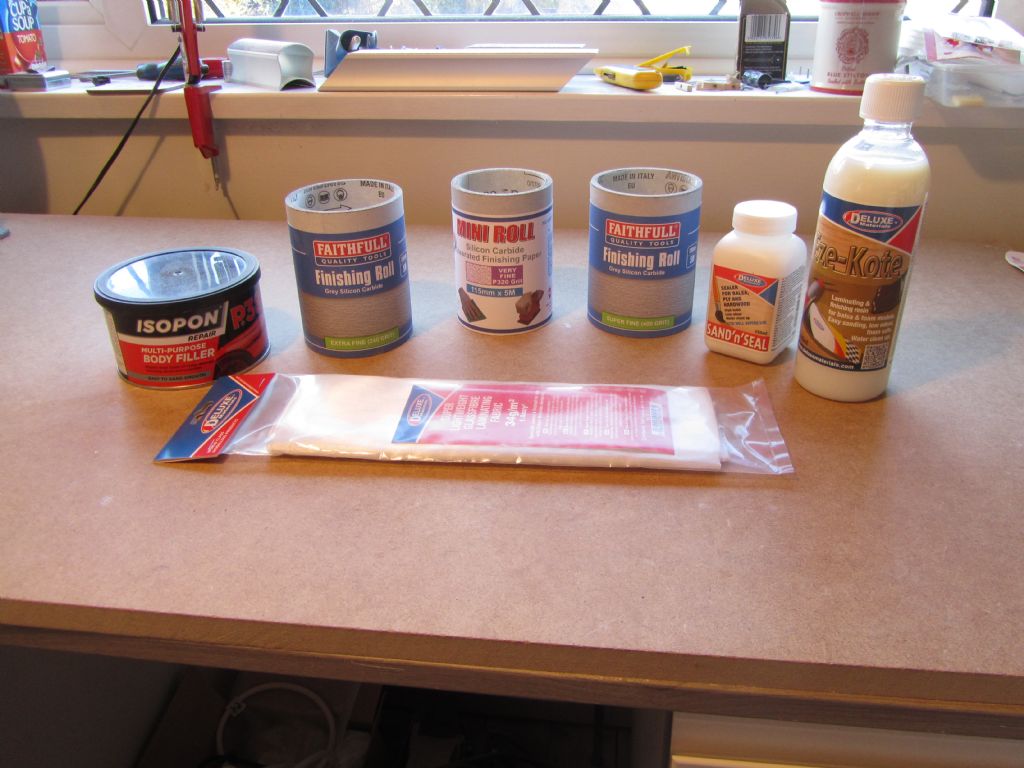

                              Nothing much to add really as all I've done is a little filling to the roof and sanding with a finer grit. Really pleased with how the roofs have come out.
                              I'd collected the materials for finishing (following DM's recommendations of course smiley) a little while ago but won't do much more until the weather is conducive to painting etc.

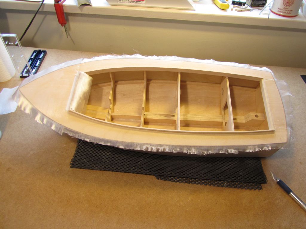

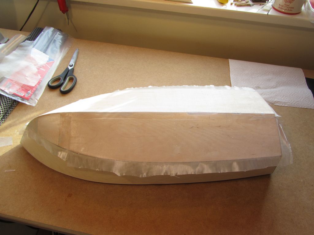

                                ready for resin & cloth.jpgbottom resin & cloth.jpgside cloth.jpgReturned to the River Cruiser having spent some time on the Huntsman 28.

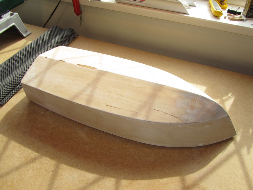

                                Did a little more filling to the bow to fill in some small depressions left after the initial filling with P38 and gave the whole hull a sand, smooth as a baby's bottom now!
                                As the hull has been built in birch ply I could just resin the balsa/filler to the bow and it would be ready for painting. But to tie in the various materials and where I'd filled in screw holes left after fitting the skins and some surface blemished in the birch ply I decided to resin and cloth the whole hull including the ply deck as this is to be painted as well. I also wanted to take the cloth over the keel to give a nice smooth finish.
                                Glad I did as the resin and cloth does give a really nice uniform finish for painting. Before I do that though I've got to make another blinkin' order to SLEC! I ordered some different sizes of mahogany last time for these builds and for when I start the Fisherman 27 but didn't get any for the rubbing strips.
                                I really must try and focus and make sure (well try!) that I get all the timber that I need.
                                Once the rubbing strips and chine rails have been fitted (no spray rails, yippee!) I can start painting, which will be done outside.

                                  You are dead right to glass the hull to tie in the various materials and like you, I have found it makes a great uniform base for painting.
                                  Your fleet is coming along nicely.

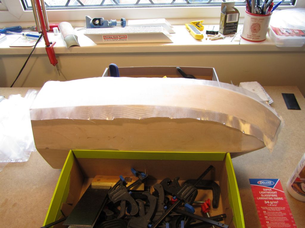

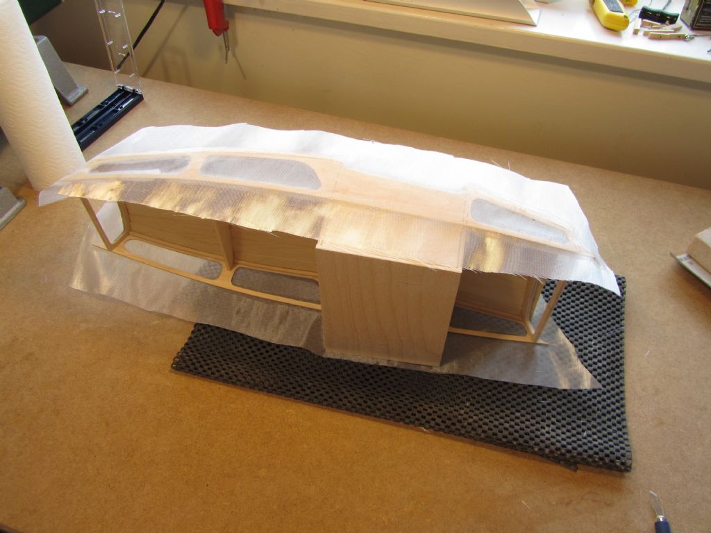

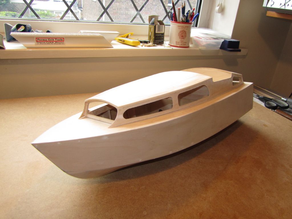

                                      roofs clothed.jpgcabin sides clothed.jpgall clothed 1.jpgall clothed 2.jpgCarried out glassing to the roofs and sides of the superstructure. Just need to do some Sand "n" Seal to the ply inside the cockpit, fit the rubbing strips once obtained, apply another coat of resin to the hull and superstructure and a final sand and it's ready for painting.
                                      Well, before I do that I'd better fit the prop shaft and make a stand.
                                      Edited By Chris Fellows on 05/05/2019 18:39:19
                                      #82175
                                        @timrowe83142
                                        Hi Chris
                                        A proper little boat now.
                                        As a matter of interest what the weight of the glass cloth you used?
                                        Tim R
                                        #82177
                                          Hi Tim
                                          Yes, I'm really glad I decided to build it now, even though it's not a fast boat. The design has really grown on me.
                                          The cloth is 34g/m2 which I get from Deluxe Materials.

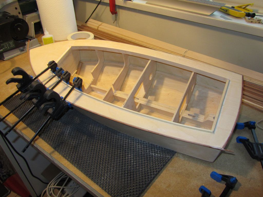

                                              Fitting of rubbing strips and chine rails now completed. Top corner of chine rails rounded off and bottom corner has just had the sharp corner taken off so that the paint adheres. Not that the corner has to be sharp anyway, this being a cruiser.
                                              As mentioned earlier next jobs are making a stand and fitting the prop shaft etc.

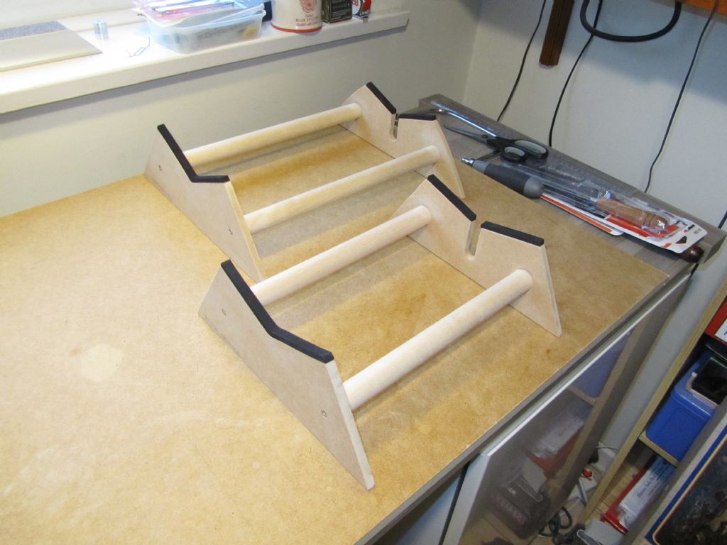

                                                      Been a few weeks since I did anything on the River Cruiser but a couple of days ago I fitted the toe rails which are ready for sanding the corners off. I was going to do it before but I'd used most of my 1.6 x 1.6mm mahogany so had to order some more. As usual I had to add a few other things to make the postage worthwhile!
                                                      Next job (and to the Huntsman 28) is to fit the prop shaft and engine mounting etc. so today I made the stands for each boat.
                                                      I used my chop saw for cutting the dowels square and made a bit of a mess firing saw dust over the window cill etc. (I think that collection bag is in the shed somewhere) so I finished off by having a tidy up and vacuum.
