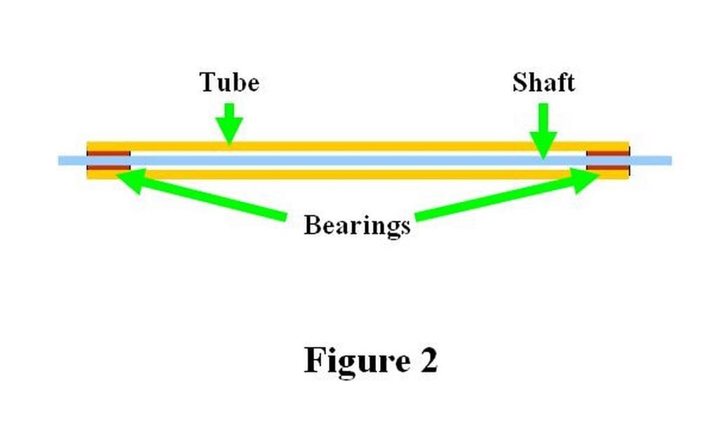

Propeller Shaft and Tube
These are usually supplied as a complete set, with a length quoted which describes the length of the tube. A brass tube with a steel shaft that rotates within it is the usual combination of materials. The shaft is supported by two short bearings fitted to each end of the tube, Figure 2. The shaft should slide smoothly through these bearings and rotate freely but with no noticeable ‘play’ or sideways movement of the shaft within the bearings, Figure 3. If the shaft is reluctant to pass through the bearings and/or rotate easily then you might want to replace it rather than hope that it will ‘free up’ with use later on. If excessive play is found between the shaft and bearings then you really have to replace it as it will cause no end of subsequent problems.
The more curious amongst you might ask why not use a simple close fitting tube to support the whole length of the shaft and so save the need for two bearings. There are two answers to this question. Firstly, it is rare to find a propeller shaft that is exactly straight. Forcing even a slightly bent shaft into a close fitting tube will result in lots of friction when the motor tries to turn the propeller. This will in turn lead to poor performance (speed and duration) and possibly an overheated motor which may reveal its unhappiness by attempting to ignite inside the model. Before anyone suggests using a tube with a slightly larger internal diameter, it must be pointed out that this will just provide a path up which water will readily flow, never a good idea in any marine craft.
The second reason is to do with lubrication. If the space between the shaft and tube is filled with lubricant it will reduce the friction with the bearing surfaces as the shaft rotates. It can also act as a barrier to any water that tries to seep past the lower tube bearing. If a straight shaft were running in a close fitting tube some lubricant would still be required between the rotating shaft and inner tube surface. The gap between these two would be very small (close fitting remember) and lubricant would create a large ‘viscous drag’ as the surfaces move past each other. This effect can be surprisingly large as I found with a small steam powered model in which this ‘viscous drag’ in a close fitting tube was high enough to stall the engine. With the tube firmly embedded in the model, the only solution was to reduce the diameter of the middle part of the shaft to create a bigger gap between shaft and tube wall. Thankfully this worked but it would have been an unnecessary chore had the kit manufacturer done their job properly.
Of course someone is going to now suggest using a plastic tube which will have less friction. But it will also be more flexible. Lack of stiffness in any rotating system can lead to vibration, excessive wear and quite often loud unwelcome noises. Suitable plastics can however be used to make the bearings for metal tubes provided they produce smooth operation without any ‘play’.
