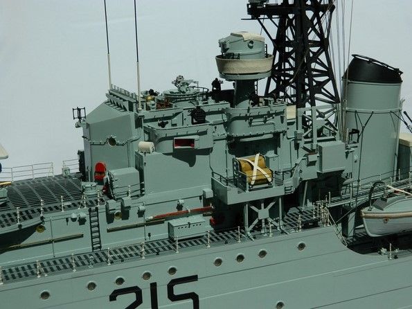

HMCS Haida: This was a Tribal class destroyer and the model depicts her as in 1960. The drawings came from Douglas Monroe of Vanguard Model Marine in Ottawa and ‘Friends of Haida’ provided much of the detail research information required. The Tribal class was of 27 destroyers built between 1937 and 1943 which saw service with the Royal Navy, Royal Australian Navy and the Royal Canadian Navy. HMCS Haida is the only surviving example of the class and is now a museum ship on the waterfront at Hamilton, Canada.
The model was built during 39 months from 2009 to 2012, is to a scale of 1:60 and is 75.4ins (191.5cm) long. Weight is 38lbs (17.2kg) and propulsion is by a single 12v motor geared to the propshafts. The radar scanners rotate and the model has a top speed of 6 mph (9.6 kph).
